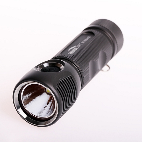

zebralight SC600 Mk III XHP35 冷白 18650 頭燈
$3,200
內置的過放電保護
可快速選擇設置各檔亮度
採用航空級優質實心鋁棒
關機=》按1下進入高亮=》再按2下進入另一高亮
關機=》按2下進入中亮=》再按2下進入另一中亮
關機=》按3下進入暴閃=》再按2下進入另一暴閃
關機=》按4下進入電量測試
關機=》長按進入低亮,持續長按,低中高循環。
高1、中1、低1是固定的,另一個可設定。
點亮狀態(低/中/高)=》連續切換5次(按2下方式切換),
第6次開始就會在3個子檔切換,選好後,按1下關掉,就設定好了。
#暴閃不能設定只能切換。
Main Features and Specifications
  • LED: Cree XHP35 Cool White (Nominal CCT 5700K)
  • User Selectable Levels: 3 main levels (High, Medium and Low). Each main level can be programmed to one of its two sub-levels. The second sub-level of the each main levels can be further programmed to different brightness levels.
  • Light Output (runtimes)
    • High:        H1  1300 Lm (PID, approx 2.2 hrs)   or  H2 670 Lm (PID, 2.8 hrs)/360 Lm (4.3 hrs)/160 Lm (12 hrs)
    • Medium:  M1  70 Lm (33 hrs)   or   M2 32 Lm (73 hrs)/12 Lm (8 days)
    • Low:         L1  3.8 Lm (18 days)  or  L2 0.43 Lm (2.8 months)/0.06 Lm (5.1 months)/0.01 Lm (7.1 months)
    • Beacon Strobe Mode: 0.2Hz Beacon at Low / 0.2Hz Beacon at H1 / 4Hz Strobe at H1 / 19Hz Strobe at H1
  • Operating Voltage Range: 2.7V - 6.0V
  • Battery: One 18650 size (i.e. unprotected, 65.0-65.2 mm long) 3.6-4.35V li-ion rechargeable. Batteries are not included in the package.
  • Parasitic Drain: Negligible (much less than the self discharging of a battery)
  • Beam Type
    • 80 degree spill
    • 10 degree hot spot
  • Dimensions
    • Head Diameter: 1.2 inch (30 mm)
    • Body Diameter: 0.98 inch (25 mm)
    • Length: 3.8 inch (96 mm)
  • Weight
    • 2.26 oz (64 gram) without battery
  • Features
    • PID thermal regulated outputs (two highest output levels)
    • Builtin battery protections with continuously monitored temperature, current, and voltage, plus a (2.7V) low voltage cutoff
    • Battery capacity indicator (LED flashes 1-4 times, 4 short clicks to start)
    • Automatic stepping down from High to Medium, and from Medium to Low when battery capacity is low
    • Durable electronic soft-touch switch
    • Smart user interface provides fast and easy access to all brightness levels and beacon-strobes.
    • Precision machined unibody casing from premium grade  aluminum bar stocks
    • Proprietary heat sinking design bonds the LED board directly to the unibody aluminum casing
    • Durable natural hard anodized finish (Type III Class I)
    • Sealed and potted LED driver circuitry
    • Tempered optical grade glass
    • Orange peel textured reflector
    • Battery reverse polarity protection
    • Pocket clip
    • Lanyard ring
    • Waterproof to IPX7 (2 meters, 30 minutes)
