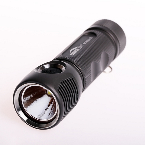

(停產) zebralight SC600w Mk III XHP35 中白 18650 頭燈
$3,200
內置的過放電保護
可快速選擇設置各檔亮度
採用航空級優質實心鋁棒
關機=》按1下進入高亮=》再按2下進入另一高亮
關機=》按2下進入中亮=》再按2下進入另一中亮
關機=》按3下進入暴閃=》再按2下進入另一暴閃
關機=》按4下進入電量測試
關機=》長按進入低亮,持續長按,低中高循環。
高1、中1、低1是固定的,另一個可設定。
點亮狀態(低/中/高)=》連續切換5次(按2下方式切換),
第6次開始就會在3個子檔切換,選好後,按1下關掉,就設定好了。
#暴閃不能設定只能切換。
Main Features and Specifications
- LED: Cree XHP35 Neutral White (Nominal CCT 4500K)
- User Selectable Levels: 3 main levels (High, Medium and Low). Each main level can be programmed to one of its two sub-levels. The second sub-level of the each main levels can be further programmed to different brightness levels.
- Light Output (runtimes)
- High: H1 1126 Lm (PID, approx 2.2 hr) or H2 580 Lm (PID, 2.8 hr)/312 Lm (4.3 hr)/139 Lm (12 hr)
- Medium: M1 61 Lm (33 hrs) or M2 28 Lm (73 hrs)/10 Lm (8 days)
- Low: L1 3.3 Lm (18 days) or L2 0.37 Lm (2.8 months)/0.05 Lm (5.1 months)/0.01 Lm (7.1 months)
- Beacon Strobe Mode: 0.2Hz Beacon at Low / 0.2Hz Beacon at H1 / 4Hz Strobe at H1 / 19Hz Strobe at H1
- Operating Voltage Range: 2.7V - 6.0V
- Battery: One 18650 size (i.e. unprotected, 65.0-65.2 mm long) 3.6-4.35V li-ion rechargeable. Batteries are not included in the package.
- Parasitic Drain: Negligible (much less than the self discharging of a battery)
- Beam Type
- 80 degree spill
- 10 degree hot spot
- Dimensions
- Head Diameter: 1.2 inch (30 mm)
- Body Diameter: 0.98 inch (25 mm)
- Length: 3.8 inch (96 mm)
- Weight
- 2.26 oz (64 gram) without battery
- Features
- PID thermal regulated outputs (two highest output levels)
- Builtin battery protections with continuously monitored temperature, current, and voltage, plus a (2.7V) low voltage cutoff
- Battery capacity indicator (LED flashes 1-4 times, 4 short clicks to start)
- Automatic stepping down from High to Medium, and from Medium to Low when battery capacity is low
- Durable electronic soft-touch switch
- Smart user interface provides fast and easy access to all brightness levels and beacon-strobes.
- Precision machined unibody casing from premium grade aluminum bar stocks
- Proprietary heat sinking design bonds the LED board directly to the unibody aluminum casing
- Durable natural hard anodized finish (Type III Class I)
- Sealed and potted LED driver circuitry
- Tempered optical grade glass
- Orange peel textured reflector
- Battery reverse polarity protection
- Pocket clip
- Lanyard ring
- Waterproof to IPX7 (2 meters, 30 minutes)
