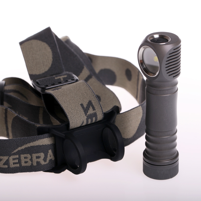

(停產) zebralight H603w Mk III XHP35 中白 18650 頭燈
$3,200
內置的過放電保護
可快速選擇設置各檔亮度
採用航空級優質實心鋁棒
關機=》按1下進入高亮=》再按2下進入另一高亮
關機=》按2下進入中亮=》再按2下進入另一中亮
關機=》按3下進入暴閃=》再按2下進入另一暴閃
關機=》按4下進入電量測試
關機=》長按進入低亮,持續長按,低中高循環。
高1、中1、低1是固定的,另一個可設定。
點亮狀態(低/中/高)=》連續切換5次(按2下方式切換),
第6次開始就會在3個子檔切換,選好後,按1下關掉,就設定好了。
#暴閃不能設定只能切換。
Main Features and Specifications
- LED: Cree XHP35 Neutral White (Nominal CCT 4500K)
- User Selectable Levels: 3 main levels (High, Medium and Low). Each main level can be programmed to one of its two sub-levels. The second sub-level of the each main levels can be further programmed to different brightness levels.
- Light Output (runtimes)
- High: H1 1126 Lm (PID, approx 2.2 hr) or H2 580 Lm (PID, approx 2.8 hrs) / 312 Lm (4.3 hrs) / 139 Lm (12 hrs)
- Medium: M1 61 Lm (33 hrs) or M2 28 Lm (73 hrs) / 10 Lm (8 days)
- Low: L1 3.3 Lm (18 days) or L2 0.37 Lm (2.8 months) / 0.05 Lm (5.1 months) / 0.01 Lm (7.1 months)
- Beacon Strobe Mode: 0.2Hz Beacon at Low / 0.2Hz Beacon at H1 / 4Hz Strobe at H1 / 19Hz Strobe at H1
- Light output are ANSI out the front (OTF) values. Runtimes tested (and parasitic drain estimated) using ZL634 batteries. Runtimes of the two PID controlled levels (1126Lm and 580Lm) vary greatly with ambient temperature and air circulation.
- Operating Voltage Range: 2.7V - 6.0V
- Battery: One 18650 size (up to 69mm long) 3.6V-4.35V li-ion rechargeable. Batteries are not included in the package.
- Parasitic Drain: Negligible (much less than the self discharging of a battery)
- Beam Type
- 120 degree flood
- Dimensions
- Head Diameter: 0.95 inch (24.2 mm)
- Length: 3.85 inch (97.8 mm)
- Weight
- 1.4 oz (39 gram)
- 3.0 oz (84.6 gram) with ZL634 battery
- 4.4 oz (124.6 gram) with ZL634 battery and headband
- Features
- PID thermal regulated outputs (1126Lm and 580Lm)
- Battery capacity indicator (LED flashes 1-4 times, 4 short clicks to start)
- Automatic stepping down from High to Medium, and from Medium to Low when battery capacity is low
- Builtin over-discharging protection (2.7V cutoff)
- Durable electronic soft-touch switch
- Smart user interface provides fast and easy access to all brightness levels and beacon-strobes.
- Precision machined unibody casing from premium grade aluminum bar stocks
- Proprietary heat sinking design bonds the LED board directly to the unibody aluminum casing
- Durable natural hard anodized finish (Type III Class I)
- Sealed and potted LED driver circuitry
- Battery reverse polarity protection
- Tempered optical grade glass
- Waterproof to IPX7 (2 meters, 30 minutes)
