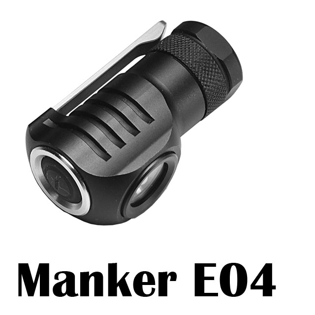

Manker E04 含電池 550流明迷你拐角燈 尾部磁吸 USB直充
規格和功能:
LED:Cree XPL HD LED
由1x 16340或1x CR123電池供電

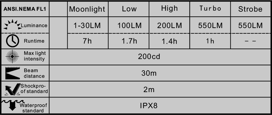

Brightness Levels & Runtime
Moonlight: 1-30lm 7hrs,
Low 100lm 1.7hrs,
High 200lm 1.4hrs,
Turbo 550lm 1hrs,
Strobe 550lm

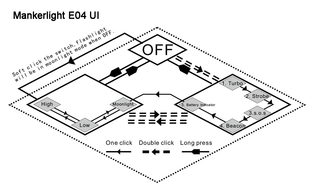

1.When the flashlight is off, one click, access to moonlight mode (left part of the figure), one click to circle: moonlight-Low-Medium -High. Long press
for off.
2.When the flashlight is off, long press to access to the mode your last use as in left part of the figure (Memory function), one click for circle. Long press for off.
3.When the flashlight is off, double click access to Turbo, one click for circle. Long press for off.
4.When the flashlight is on, double click to switch between the two groups(left and right part of the figure)
