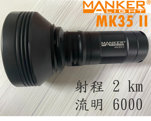

【限時特價】Manker MK35 II SBT90.2 射程2km 流明6000 多種檔位 高亮度強光手電筒 兼容行動電源 標配含原廠鋰電池賣場 特價品

採用Luminus SBT90.2 LED, 輸出達6000lm
1,000,000cd, 射程達2km
使用4粒IMR18650 (可選配)
USB-C快速充電, 電筒也可為其他電子產品充電
呎吋 185mm x 109mm(頭)/53mm(身)
重量 737g
附送肩帶, USB-C線, O-Ring
 我們提供批發、公司行號採購協助
 不定期商品特價優惠
 新品資訊搜尋FB粉絲團:電筒王
 買電筒找我們
原廠總代理公司貨
Features:
- Emitter: 1* LUMINUS SBT-90 GEN2 LED
- Maximum output: 6,000 lumens
- Maximum beam intensity: 1,000,000cd
- Maximum beam distance: 2,000 meters
- Power by 4* 18650 batteries (Excluded)
- Working voltage: 2.8v - 4.35v
- Driver: Most efficient constant current circuit
- Over charge & over discharge protection
- Anti-reverse battery protection
- Thermal protection circuit prevents overheating
- Intelligent discharging & charging circuit integrated on battery carrier
USB Type-C rechargeable port for fast charging (Max. charging current/ voltage: 3A, 5V)
- Have discharge function with included USB Type-C/USB OTG cable (Max. discharging current/voltage: 2A, 5V), can work as power bank
- Engineering Mode: to select different output level for ideal moonlight mode
- Lockout mode prevents accidental activation
- Battery capacity indicator shows battery level at any time
- Material: Aircraft-grade aluminum body
- Surface treatment: Premium Type III hard-anodized anti-abrasive finish
- Lens: Toughened ultra-clear glass lens with anti-reflective coating
- Waterproof standard: IPX-8 (2 meter under water)
- Impact resistance: 1 meters
- Tail stand
- Size: 185mm (length) x 109mm (Head Diameter) x 53mm (Body Diameter)
- Weight: 737gram (without battery)
- Accessories included: Spare o-ring *1, Shoulder strap *1, USB Type-C/USB OTG cable *1, USB Type-C charging cable *1, User manual *1
Brightness levels & runtime:
- Moonlight 0.1-22lm 120days
- Low 245lm 20hrs
- Medium1 575lm 9.5hrs
- Medium2 1150lm 4.6hrs
- High: 2500lm 2hrs
- Turbo 6000lm -2500lm 1.5hrs
- Strobe 6000lm
