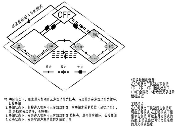

3. Multi-brightness levels available: Moonlight, Low, High, Turbo, Strobe, SOS, Beacon.
4. Lock out & Engineering mode function: Lock out can prevent the light accidental turn on. Engineering Mode is able to program the lowest "Moonlight" from many possible, you can select comfortable moonlight for yourself.
5. Most efficiency constant current circuit and unique heat dissipation copper structure also make Manker E02H significantly different with other lights.

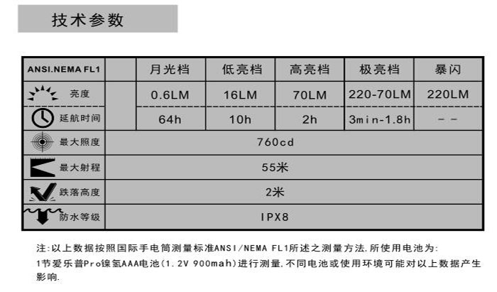

Specification:
Emitter: CREE XPG3 LED / Nichia 219C LED, CRI >90
Maximum output: 220lumens ( CREE XPG3 version)
Maximum output: 180lumens (Nichia 219C version)
Maximum beam intensity: 760cd
Maximum beam distance: 55meters
Working voltage: 0.6-1.8v
Water proof: IPX-8, 2M
Impact resistance: 2 meters
Magenetic tailcap
Driver: Most efficiency constant current circuit
Material: Aircraft-grad aluminum body
Surface treatment: Premium Type III hard-anodized anti-abrasive finish
Lens: Toughened ultra-clear glass lens with anti-reflective coating
Dimensions: 72mm (length) x 20mm (Head diameter)
Weight: 56gram
Accessories: o-ring *1, lanyard *1, user manual *1, pocket clip *1, headband *1
Brightness levels & runtime:
Moonlight 0.6lumens 64hrs
Low 16lumens 10hrs
High 70lumens 2hrs
Turbo 220-70lumens 3min-1.8hrs
Strobe 220lumens
Operation:
Lock out:
One click - Double - Triple from any mode to lock out the flashlight.
Engineering Mode (Choose output level for moonlight mode):
Quick click for 4 times from any mode to get access to engineering mode. One click to check different levels and long pres to make your final choice.
